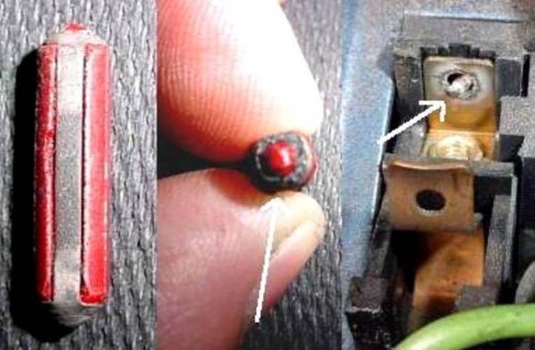

Below is a pic of one of my Window Fuses. As Forcedinduction said it looked good a first. But, when I pulled it out I got a surprise.
One Fuse connects to 2 windows 1 front and 1 rear; however they are acrossed from each other.

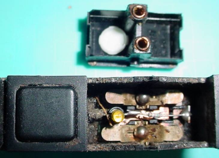

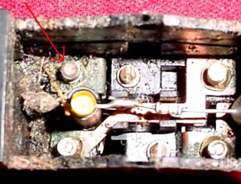

Anoter common problem area can be the Switches. They get full of crud and the Contacts inside the switch get burned up a little.
In the last pic below you can see the the red arrow pointing to one of the burned contacts, but, they are all burned to some degree. I scraped them carevully off with a knive and the Window worked again.
