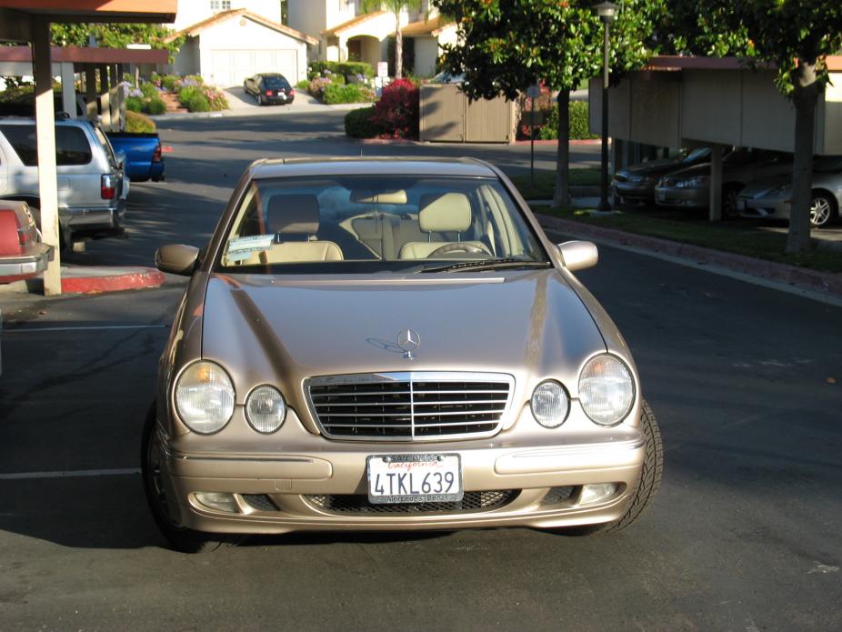

Hi Guys,
would like to get some tips on doing a tune up on my car.It's a
E320,2001None 4matic. I want to change the spark plugs . just few tips if anyone has done it before on this type of car.
Thanks
Sal
