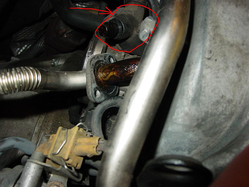

Does the part on the attached image need replaced too? I saw another site that said it should be, as it may be brittle and break. If so, what is it called and does anyone have the part#?

I cleand my egr tube yeterday and it was completely clogged. I don't know what that part in the picture is but I didn't change mines.. in my opinion if its damaged then I would replace it but mines looked fine..
