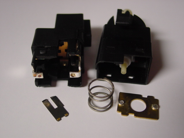

Default Brake light switch
Thank you guys for your reply. I came home from work and removed the switch, opened it up to see what is going on with all of them because this is daily repair at the dealer as I heared from mechanic that workes there for 23 years alredy. Some days even 3 MLs with this exact same problem and now I know why. Just another poor design flaw in the simple engineering, broken contact made out of wrong spring steel material that will not last probably even few thousand cycles. No offense, but this switch looks like made in China by Valeo. In the tool & die shop where I work, we make fixtures for testing Boeing and Caterpillar switches and joysticks, cycling them million times back & forth while switching temperatures from freezing to hot within a minute. Quality don't mean nothing for Mercedes any more. I also replaced burned out bulbs in my instrument cluster again, second time in three years / since I own my ML. I never have to remove cluster from my 1980 280SE and they are all working after 29 years of service. I remember replacing two of them, one in the headlight switch and one in heat control ****.
I will make the trip to stealership tomorrow to see what is the latest price for one 001 545 20 09 brake pedal switch or stop lamp switch (as W163 Mercedes Star Manual calls for).

Cool pics
When I did my brake switch (this was another repair nothing to do with abs bas est)
a big TELL TALE SIGN was that the cruise control would not engage
I wonder if this is what distinguishes the ISSUE of whether one is dealing with
1) SPEED SENSOR ISSUE OR 2) Brake light switch
I know that when I had chaffed wires - speed sensor issue - The cruise control would engage but would kick out after while
