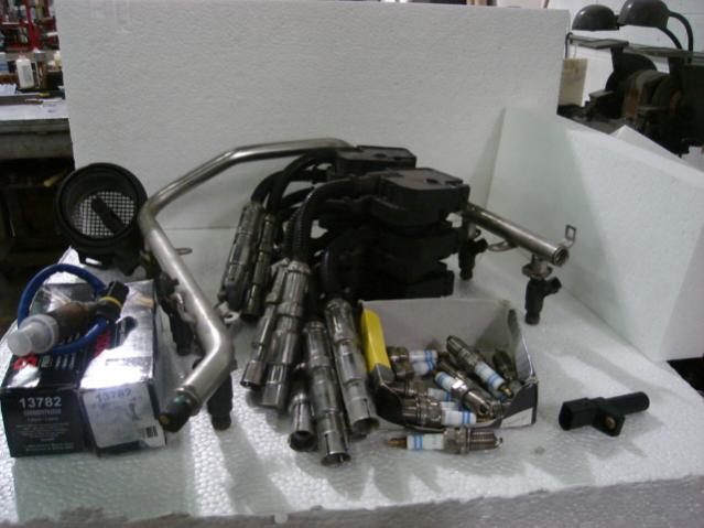

Default Misfire on hard acceleration.
This is what was replaced on my ML320 to finally fix the same symptoms. New set of front o2 sensors took care of the problem for good and can't simulate it now even if I try to!
